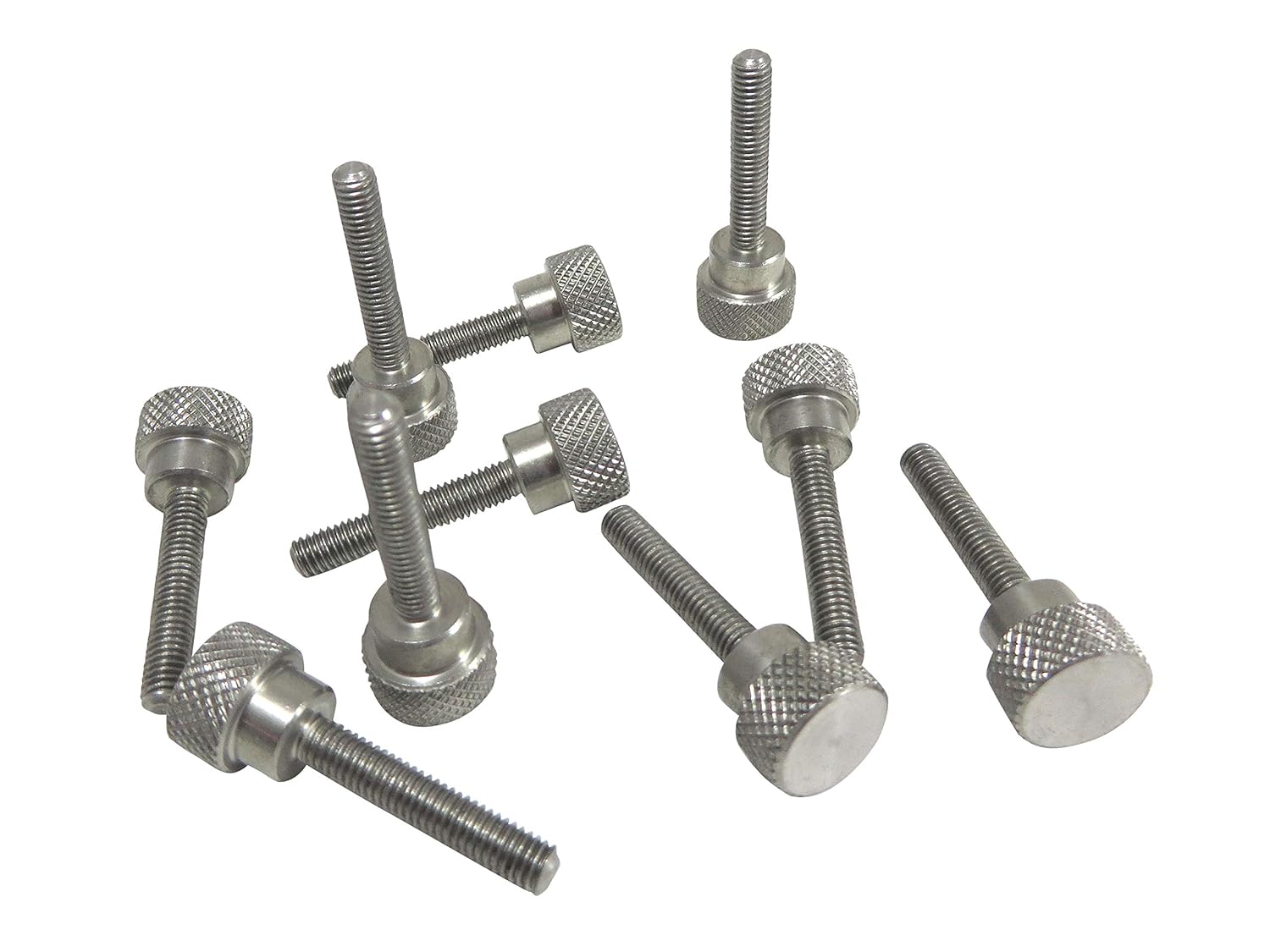

- 10-32 - Thumb Screws: https://amzn.to/3UQKmu0

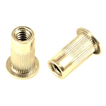

- Rivnuts: https://amzn.to/3OWRDEF

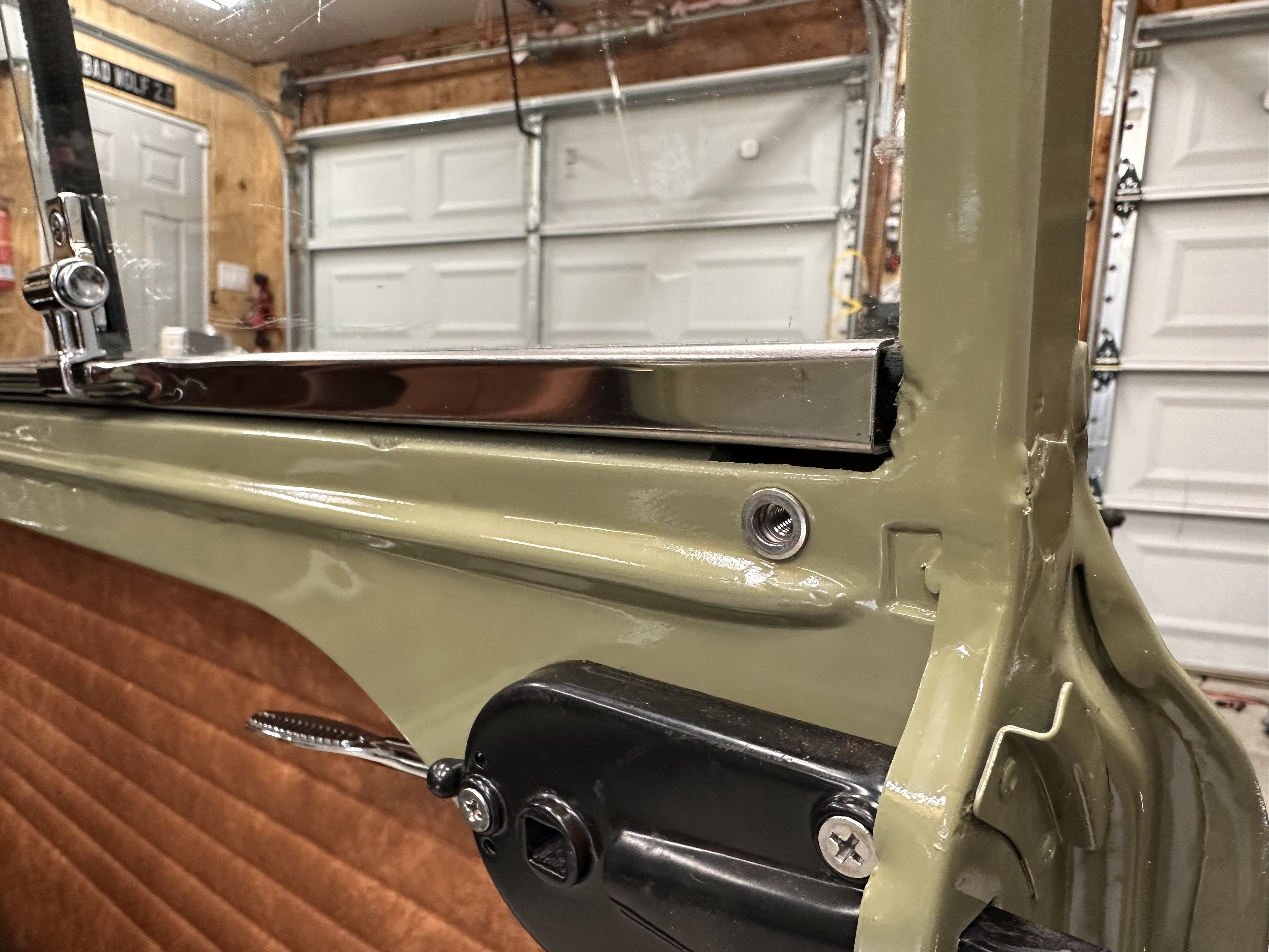

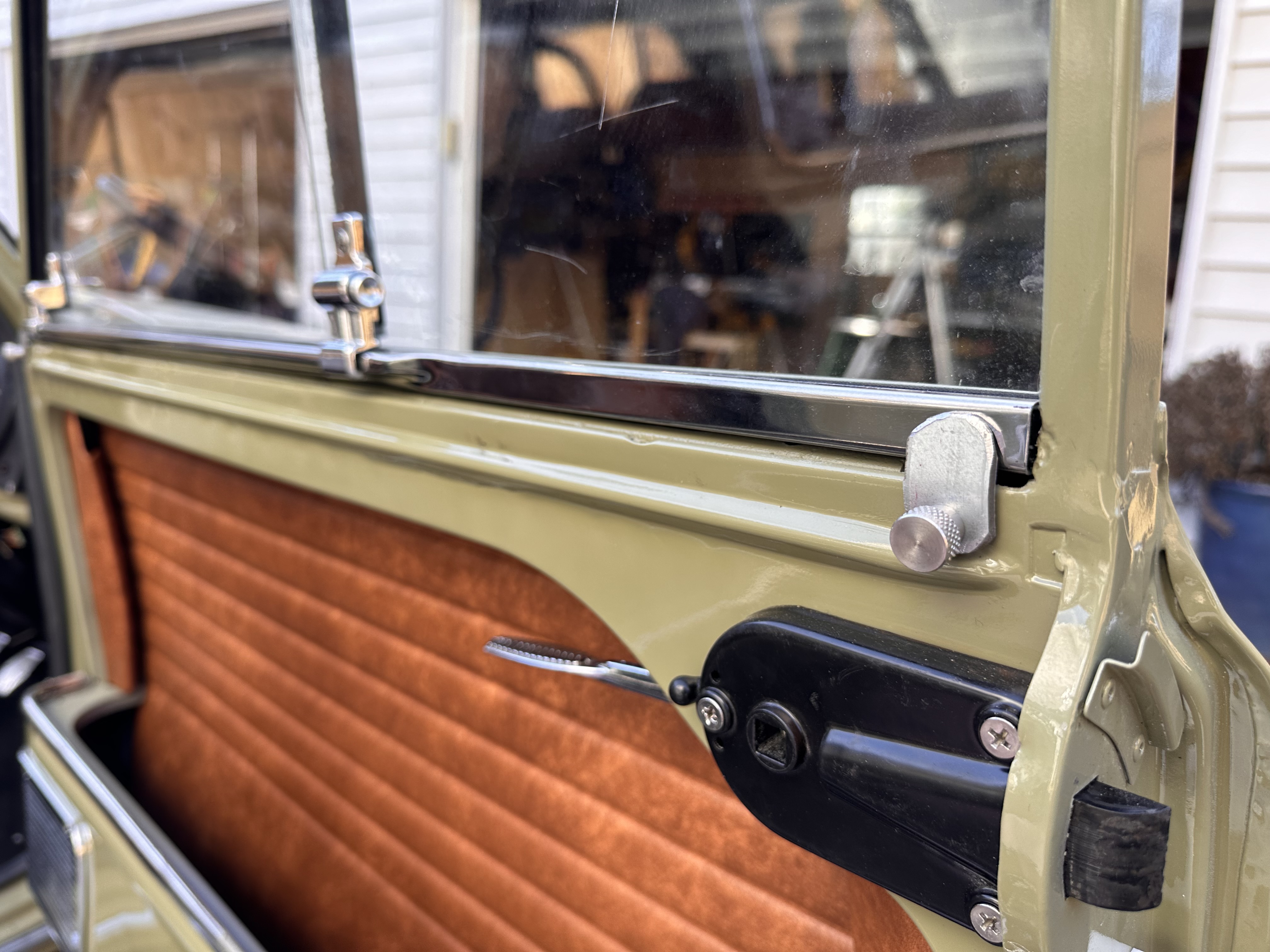

This is obviously the scariest step and if your metal is weak in these areas, I would probably not try this job on your car. Essentially you drill two holes in each door. One at the front of the rail, and one at the rear. Follow the directions for the size hole to drill and then use your rivnut tool to pull it in place.

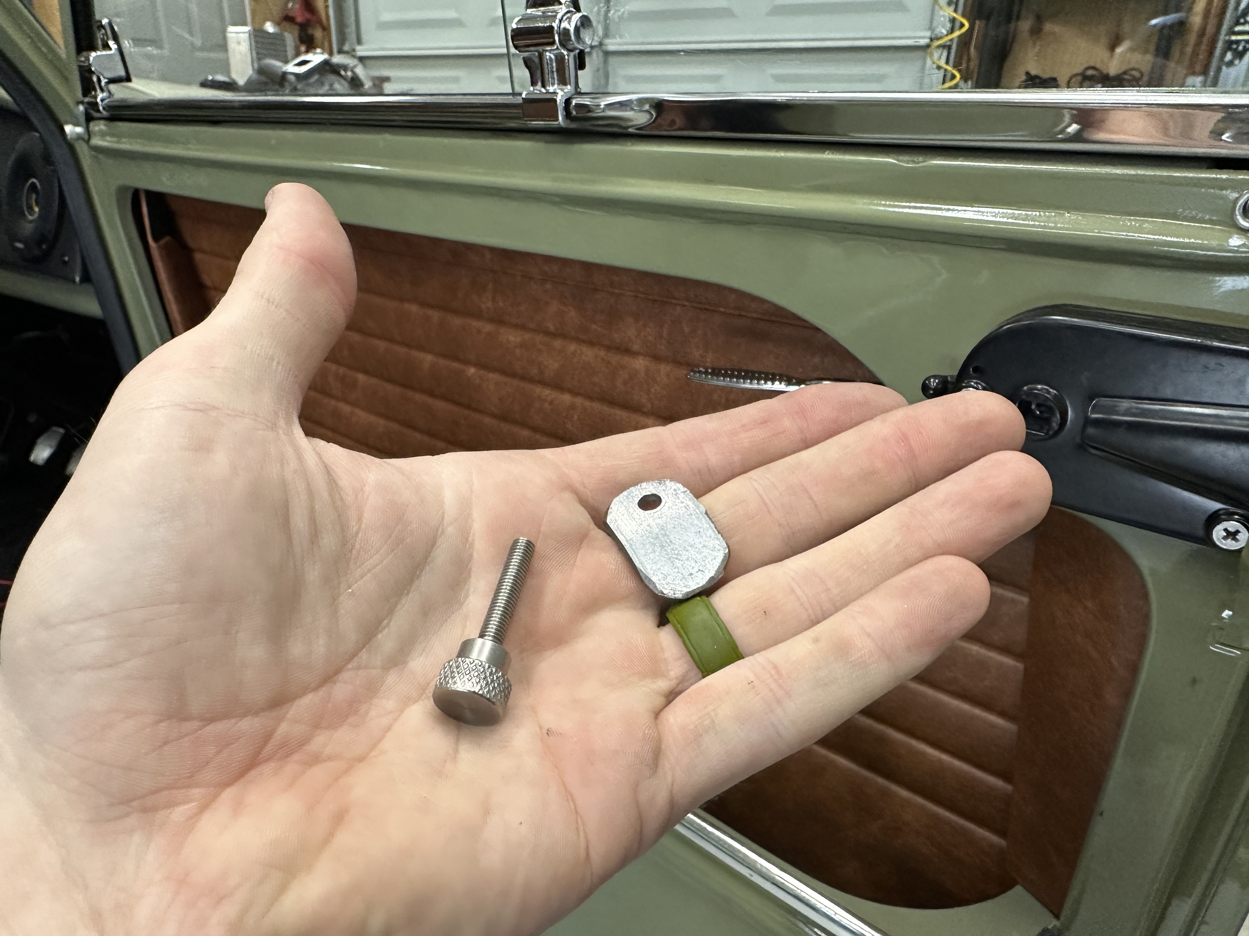

Step 3 - Create your tabs:
I bought some reasonably thick aluminum bar from my local hardware store. Something fairly substantial.
- Cut it to length, so it reaches up the front of the chrome window strip.
- Grind down the edges so they are rounded
- Give it a little bend so it kinda “pushes into the rail”
- Finally, drill a hole in the bar to allow the thumb screw to pass through.The original rails were held in via screws right through the base into the top of the door itself. You likely will need to remove the felt/gasket/gutter to get to those screws. My car was freshly repainted so my windows were already out. No screws to remove!
Step 4 - Remove the original gutter rail screws:

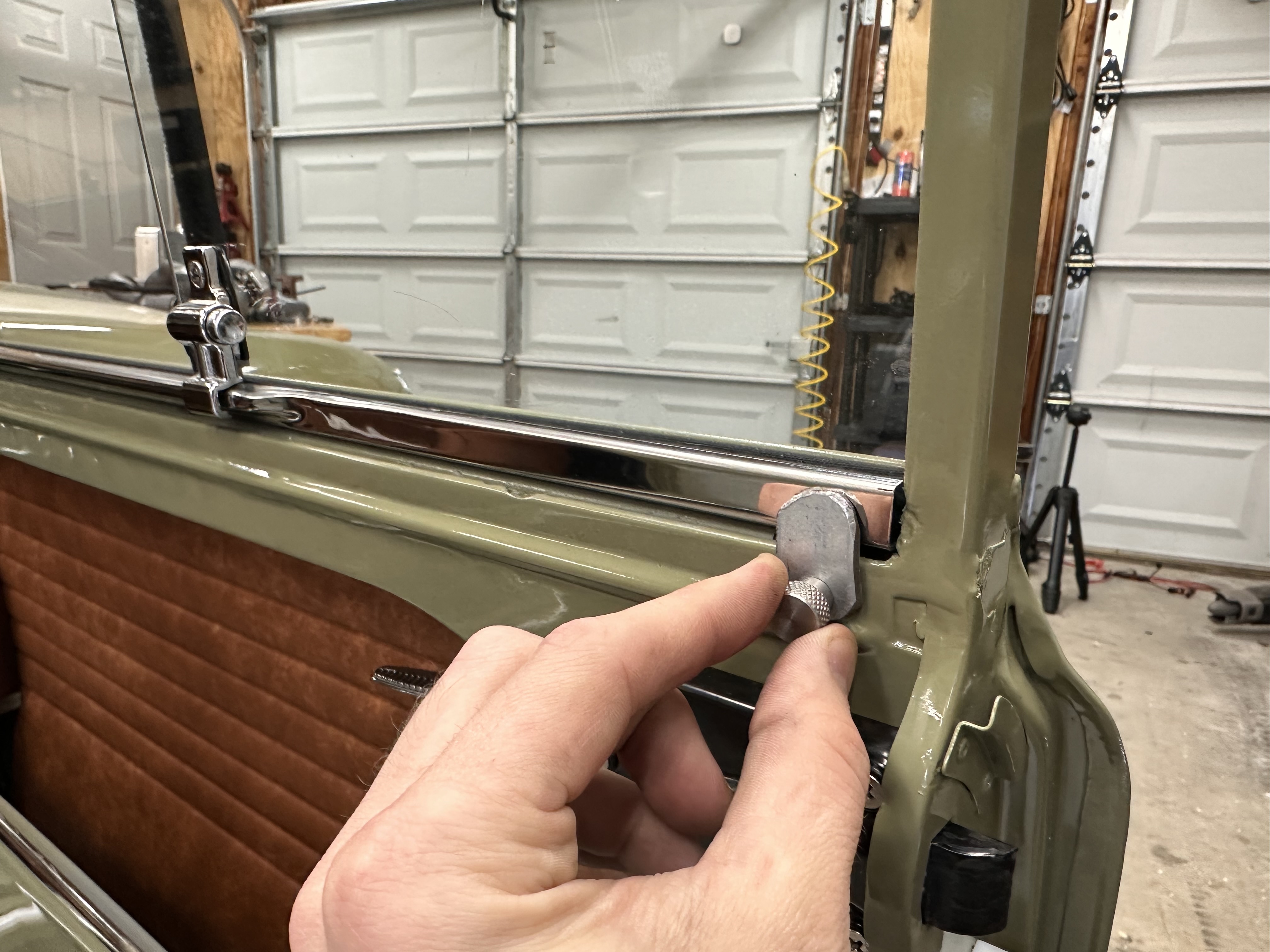

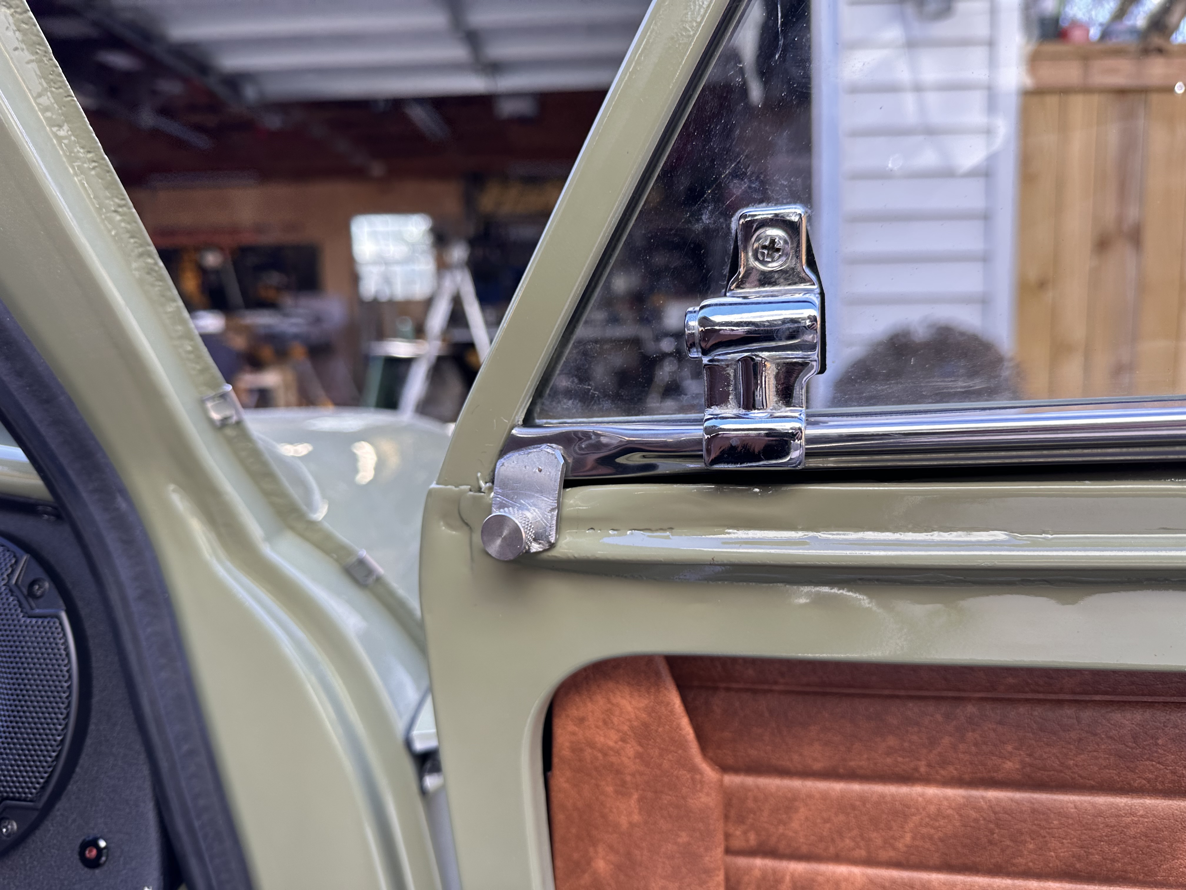

Step 5 - Screw in the new retainers:
Step 5 - Youre done:
And with that, the job is done! Just a simple set of 4 tabs, that hold the windows in. When you want to remove your windows, it's just two simple screws and then you lean the windows out. Be careful…they’re glass….
