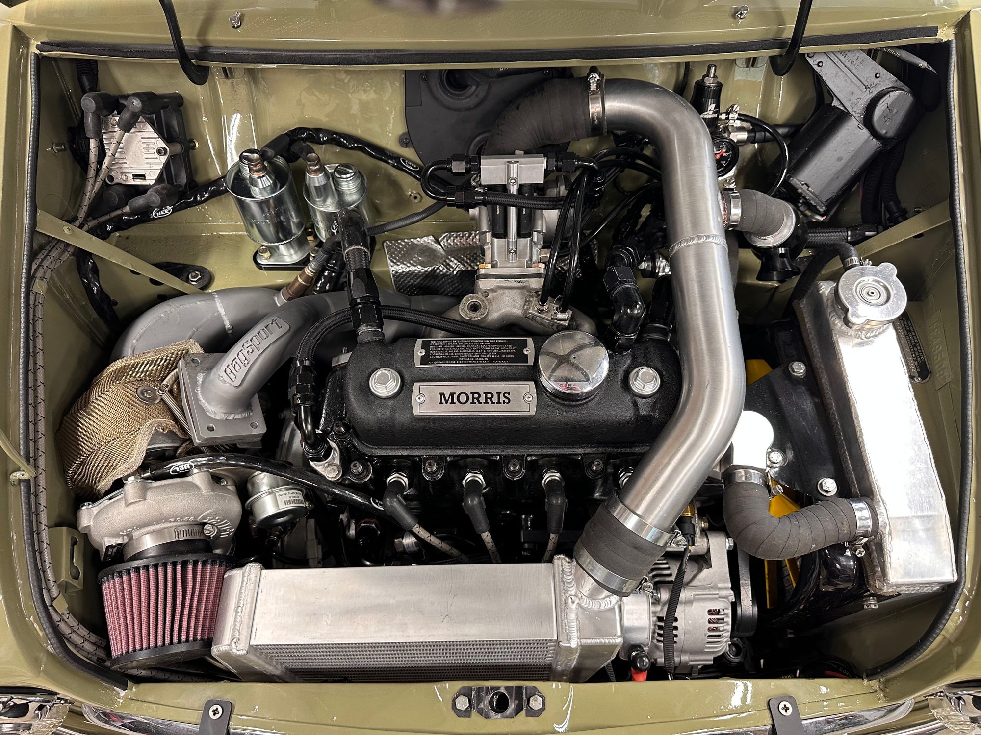

Many of you already know that I have a big honking turbo on my Classic Mini. This turbocharger sits on the left side of the engine, directly adjacent to my brake and clutch master cylinders. Some of you also probably are aware that turbos get really freaking hot.
This heat is only compounded and intensified as you put more load on the engine, and especially during the summer months, it can have big impacts on things located near the turbo.
In this case, my brake and clutch cylinders.
During original installation, I already partnered with HEL Performance to add heat-sleeved hydraulic lines, capable of handling 1200C/2200F, yes 1200C. Thinking this would be enough, I moved on to the rest of the build.
However, after getting into practical usage, I found that the original tin master cylinders ended up effectively acting as two little ovens for my brake fluid. Expanding the fluid to the point of overflowing (though I don’t think it was ever boiling), as well as creating brake fade, and issues engaging the clutch.
