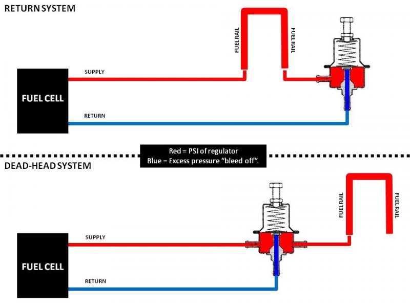

Routing the Fuel Lines
Routing fuel lines for EFI may seem like a complicated task but there are a couple of options for routing you can use when setting up your system. In both options, you will need to run a supply and return for your fuel lines to and from the tank.
Alt text
Of these two options above the "Return System" is the most desirable. Putting your fuel rail (which lives in your engine bay) before the fuel pressure regulator will reduce the overall heat being added to your fuel by virtue of pressure. Allowing all the "warmer" excess to pass out into the return and never enter your injectors.

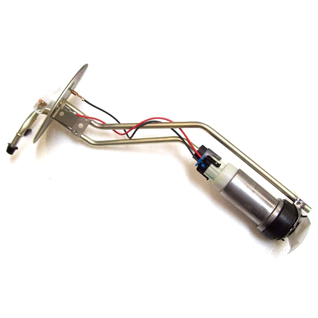

High-Pressure Fuel Pump
Alt text
With EFI you must have a high pressure 40 psi+ for your fuel injectors. This is not like a carb with a low-pressure 3psi pump. I find the easiest way to do this is to install this in an MPI Classic Mini tank. These accept universal "in-tank" fuel pumps and arrives setup with a fuel return. All EFI fueling systems require a return line for excess pressure and fuel. You can of course drill your own return line in your own tank but the MPI tank is the cleanest setup.
Order yours here: MPI Fuel Pump
Order yours here: MPI Fuel Tank

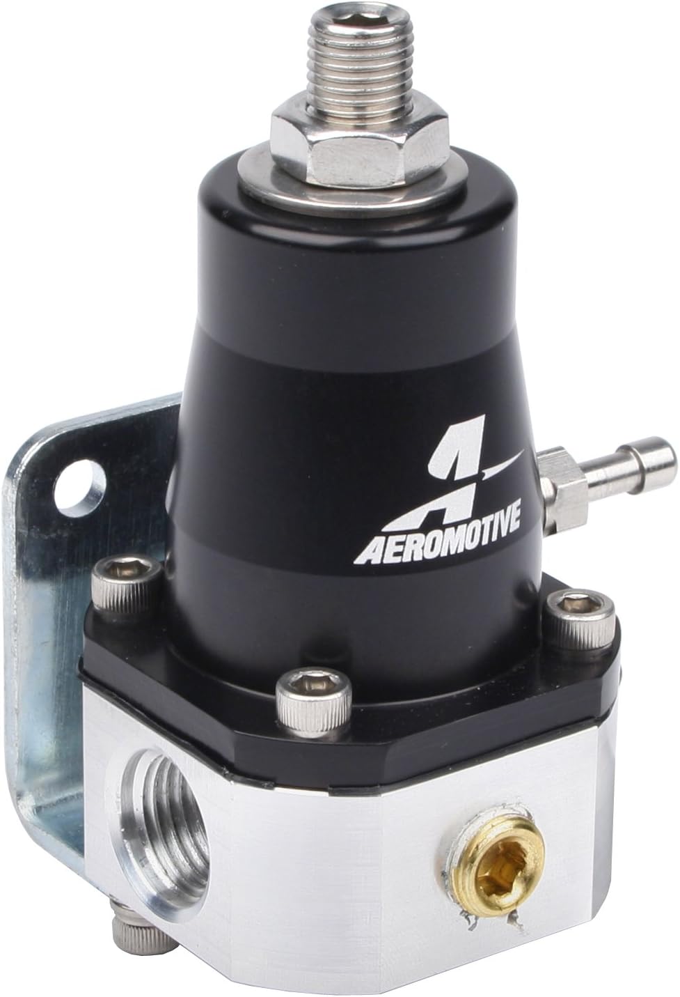

Fuel Pressure Regulator
Alt text
There are many fuel pressure regulators on the market. I've chosen the Aeromotive units as they are reliable and offer rising rate ports for boosted engines. These units will allow you to accurately stabilize and set a constant fuel pressure for NA applications, or a rising rate for boosted applications.
Order yours here: Fuel Pressure Regulator

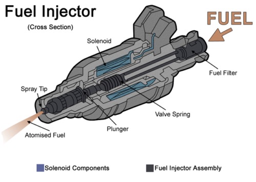

Fuel Injectors
Alt text
As the name states, these are used to inject fuel into the engine. These are replacing your SU old carburetor and are controlled from the ECU with a PW (pulse width). This allows for a precise amount of fuel to be injected as needed. Once this fuel is burned your wideband 02 sensor is used to sniff the burned fuel mixture. This allows a closed-loop control to take place (EGO correction) where the ECU can make small changes to the fueling and compensates for changing conditions.
