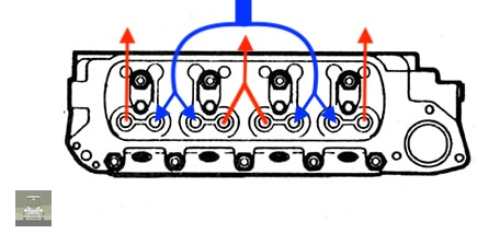

Let’s start with what charge robbing actually is in a practical sense. The mini has a “unique” (see also “bad”) design for its original cylinder heads. They use something called a Siamese Port head.
What this means is that both the intake and exhaust ports are on the same side of the head. Where it gets especially tricky is that each cylinder does not have its own intake manifold branch. Meaning cylinder 1 and 2 use the right side of the intake manifold, while cylinder 3 and 4 use the left side as viewed from the front of the car. This means that as fuel/air is being pulled into the cylinders, there are scenarios where a cylinder can rob/steal that mixture from the other cylinder in its shared port.
This is, at a high level, the reason why Classic Minis always have slightly leaner outer cylinders (1 and 4).

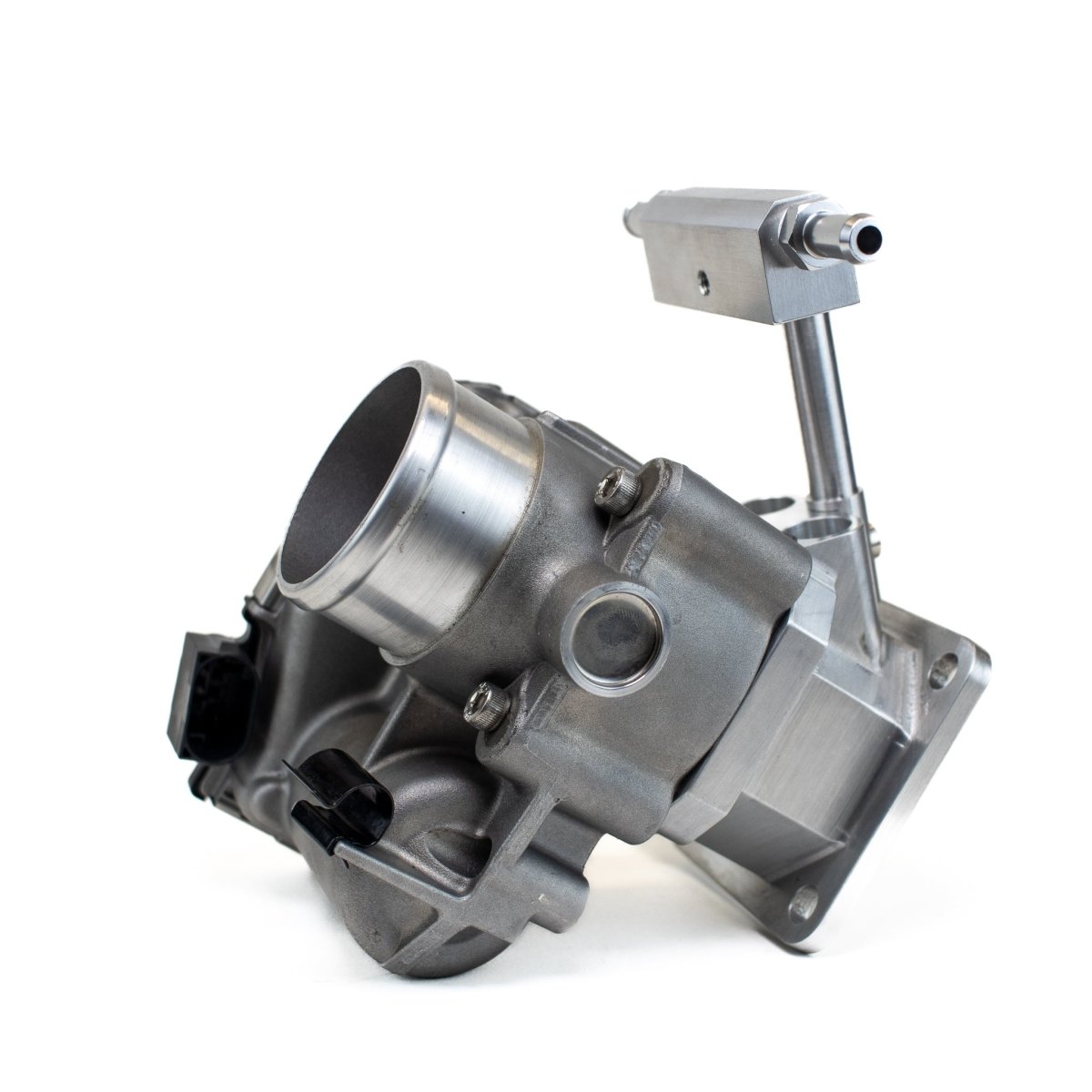

When considering your setup, it is worth mentioning that in addition to these advances in easy control in your ECU, advances in throttlebody design, such as drive by wire, have made EFI conversions even easier on older vehicles with unique fueling needs. These electronic throttles are considerably safer and more reliable when compared to the standard cable throttle. Allowing automatic fine-tooth control of idle with simple configuration in your ECU.
Shameless plug - Classic Mini DIY Drive By Wire Throttlebody
