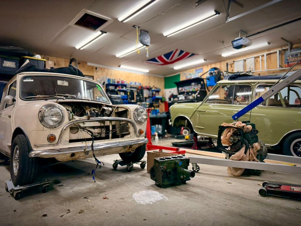

So now we get to look at our newest build: a tired 1100cc engine from a Charlotte local’s New Zealand import mini. What we originally thought was an 850 turned out to be an early 1100 with the original 12G202 head. This is excellent news because it puts us in a much different situation for a rebuild.

After taking it out of the car, getting it on the engine stand, and making an assessment, this is what we have…
  • Standard 1100cc (998cc block with special long-stroke crank)
  • 12G202 Cylinder Head with ported intakes and exhausts (pictures below)
  • Very tired problematic 3-Synchro Gearbox with Magic Wand
  • Soaked clutch and Flywheel
